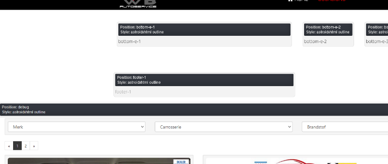

when I succeeded in showing cars from a supplier script, it shows the cars in position debug (mod-preview) at the bottom.
Can't find this position in the template layout. Next I have made in modules a custom module with position debug but it has no connection with the section I made in the layout section from the template. I dont see the solution because I want that position in the middle below the content section
Joomla 4 - template J-Power test site :wbauto.match2.eu/index.php occasions
gr. Hennie
gr. Hennie

I have to disable al the other sections for Occasions to achieve this result... but it is a pity that some other information is not available now

Don't use the modul-position 'debug'.
It's only for troubleshooting.
Use e.g. the modul-position 'footer' or top-a-1, or top-b-1, ......
Take a look into the astroid-framework/layouts!

the script "did choose this position" I cant recall that I had a choice
Tried at first to put the script at the end in the article (did work at the original site once). But it disapeared again. Hoped that the results would apear beneath the article.
And after trying some other options (including help from this forum
for example plugin options, in the backend template and in the menu position, I found accidentally the result at the very bottom at postion Debug (?).
gr. Hennie

Posted 4 years 4 days ago #31069the script "did choose this position"
I don't know what you mean or what this is.
To input an extern site, you can use the function 'wrapper' in joomla.
Did you try an other position?
And BTW: Do you still have the problem with the jquery or is it solved?

Posted 4 years 4 days ago #31072To input an extern site, you can use the function 'wrapper' in joomla.
The Debug position was apparently chosen because I put the script in the menu-item custom code. After deleting this code the Debug position was empty. After that with the Editor on none I was able to add the script and choose a postion of choise.
Thanks for thinking and helping at the end the result is how I want it!
