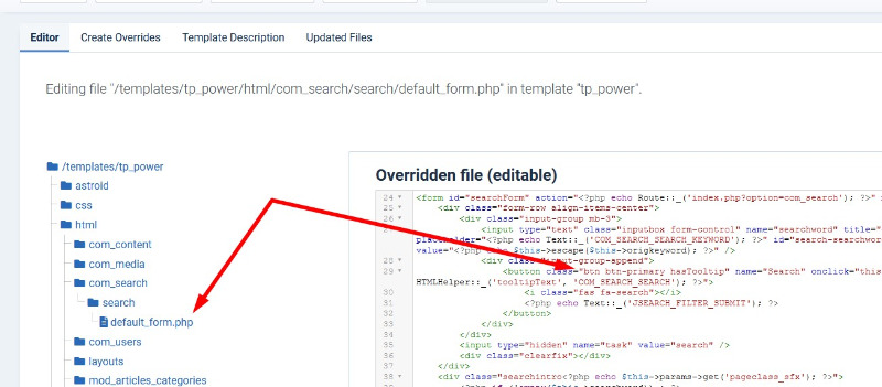

Hello support team, the buttons (on the right, search and advanced search) are displayed larger than the input line. Is there a solution for this? Joomla 4.1.0 | tp_power 1.3.7 | Astroid 2.5.15

Hallo, dass geht wie folgt:
1.) Joomla System > Site Templates > Template auswählen
2.) Editor Tab > html > mod_search > default.php auswählen
3.) Nun btn-sm hinzufügen ( siehe Bild)
entered but no change happened.

If youre using the search component instead of the search module you have to change the file html/com_search.. and not the file html/mod_search/...
