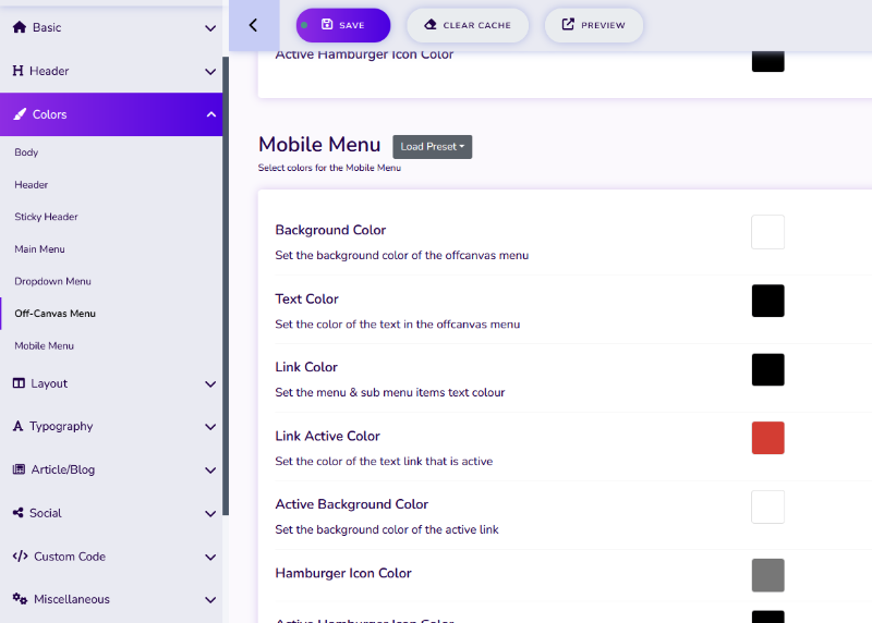

you set the colors in the template options:

The color works like a charm.

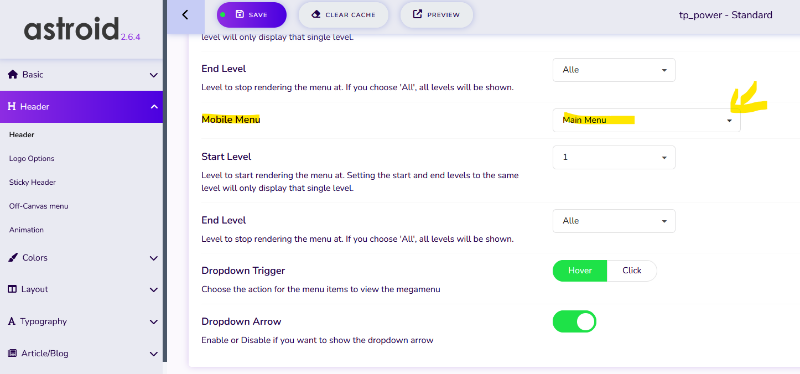

still does not fit
I have choosen main menu aswell as mobile menu but still not 100%
kind regards, Hennie
