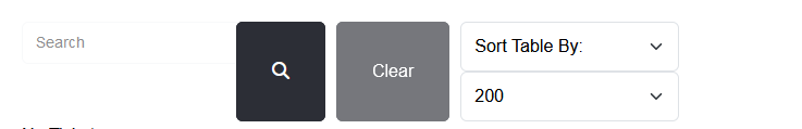

Ok, the whole story:
Joomla 5.03
astroid: 3.0.11
tp_simple: 1.3.17
I tried to fix the template error - standard search joomla field not correctly rendered
Found in tempate.css
Who is Dirk? However...
To change the code I cleared the cache and waited...and waited.... until I got an php 120 sec executioin time exception.
Changed the execution time at php.ini to 10 min and waited...and waited.... (after round about 5 Min, the compiler finished!) yeah
So something seems to be wrong with that.
To fix my issue, i edited the compiled css direktly (all corrections will be gone after next cache celarance).
Corrected css:
Joomla 5.03
astroid: 3.0.11
tp_simple: 1.3.17
/*Start Frontend Edit Modus von Dirk*/
.btn-toolbar {
display: block;
Corrected css:
.btn-toolbar {
display: flex;
flex-wrap: wrap;
justify-content: flex-end;
.ordering-select {
display: flex;
Last Edit:2 years 7 months ago
by sanus70
Last edit: 2 years 7 months ago by sanus70.

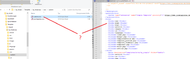

Replied by sanus70 on topic astroid-framework-3.0.11 - clear cache will result in hanging
Posted 2 years 7 months ago #34543
The question is: Why is there custom code in the original installation? And why will this result in broken layouts?
Look at: tp_simple.zip\scss\custom\custom.scss
by sanus70
Replied by WM-Loose on topic astroid-framework-3.0.11 - clear cache will result in hanging
Posted 2 years 7 months ago #34544
There is no custom code on a fresh install.
Either you use custom code in the template options or create your own custom.css in: /media/templates/site/tp_my_template/css/custom.css.
Was Joomla migrated from an existing version? Then the code was already there.
Last edit: 2 years 7 months ago by WM-Loose.
Posted 2 years 7 months ago #34545
The installer will copy the scss folder (see right side)
The fresh zip includes the custom.css
It is your original downloaded zip!
by sanus70
