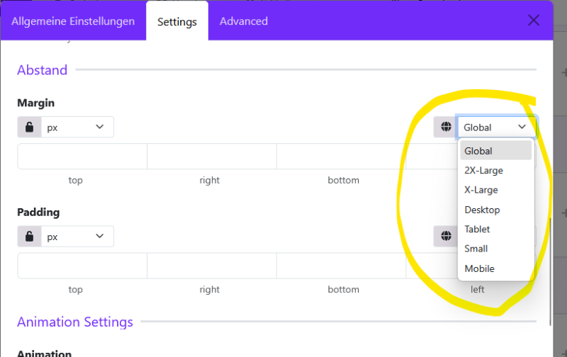

First, update the Astroid version to 3.3.3 and the template to the current version 2.5. Before updating the template, enable debug mode in the Astroid plugin. After updating the template (but update Astroid first), clear all caches (Astroid, Joomla, and browser) and then disable debug mode in the Astroid template. Now you can check if everything is working correctly. If not, you need to check and set the margin and padding for all new display sizes in the template options under Layout. There are now more display sizes (default according to Bootstrap) that you need to consider.
